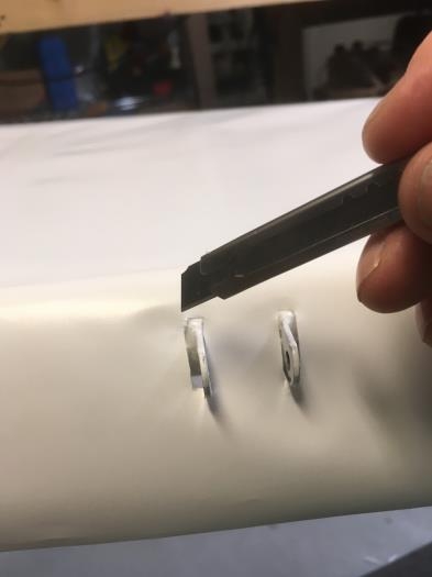

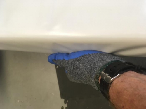

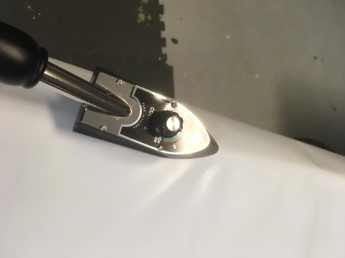

Installed the last piece of Oratex on the elevator then applied a small bead of glue around all of the edges where the fabric overlaps. This is done so that when you install the edge tapes the glue will melt and help make the transition a little smoother. I also started preping the horizontal stabilizer for covering by sanding all the rib to spar transitions and applying more superfil where needed.
Tacking in place
Tacking in place
Making cut outs
Making cut outs
Heating with heat gun and stretching to fit
