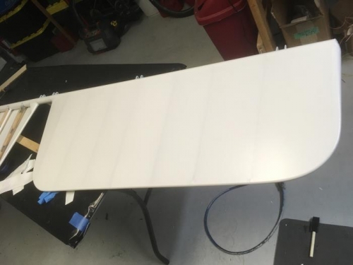

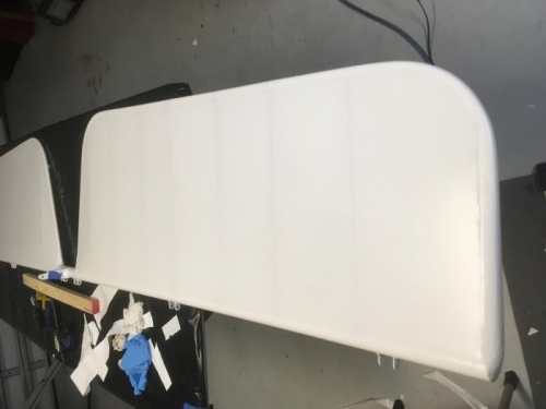

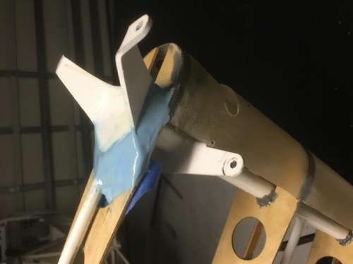

Worked on the right top half of the elevator. Since this is the first time I installed the fabric on the top and it was the finish cover on the elevator I took my time since all of the edges will be directly under the finsh tapes. I once again laid the fabric on top of the elevator in the premarked place and used the small iron to tack all of the outer edges down. I then went back and used the heat gun to pull the fabric around the tubes and the corners. It seemed to work best to heat/stretch a short section and then hold it in place about 10-20 seconds until it cooled enough to stick and then move to the next section.The rounded corners were a little tricky but they turned out good. I am hoping things will speed up now that I am getting used to using the Oratex system. I also filled the space around the rudder control horn so that the fabric will have a little more to be fasten to. I hope to install the other side tomorrow as well as heat shrink the previously installed cover.
Bottom of elevator with overlap joints
Top of elevator
Top of elevator
Rudder control horn
Rudder control horn
