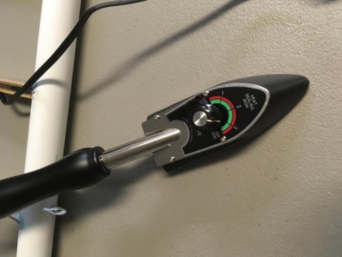

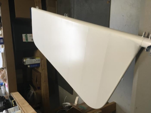

Installed the Oratex fabric to the bottom of one side of the elevator. I first used a small iron to tack all the edges in place and again used the iron to tack larger areas. Once I had the entire perimeter tacked down, I used the heat gun to complete all the glueing and to get the fabric to form around all the rounded corners. It all turned out much better that I thought it would. I took my time and moved slowly in an effort not to make any mistakes. I think things will go much faster with more experience.
Iron that comes with the kit from Kitfox
Bottom of the elevator
