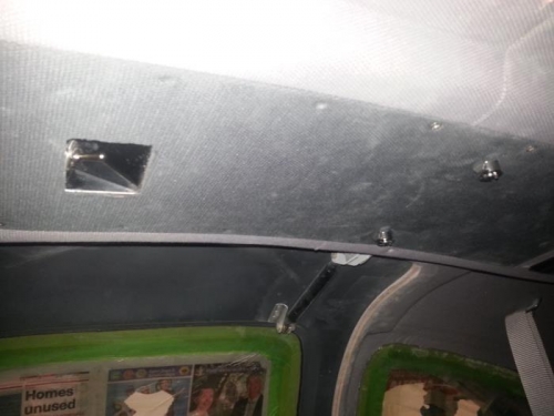

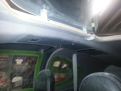

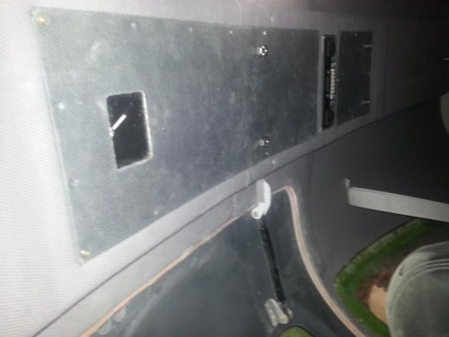

Today I setup the oxygen outputs and controller switch.
Due to the hieght of the switch for controlling the O2 system, I needed to create a angled recess into the overhead console. This took a little figuring out, however, I am quite happy with the results.
The O2 outlets are in the removable panels and are easily accessible to the pilot and passengers.
