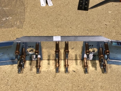

HS - Front Spar Assembly
Bent the outboard ends of HS-710 and HS-714; Dimpled HS-702 and countersink HS-710 & HS-714 for the center 4 (AN426AD4) rivets.
