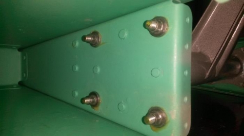

1. Control fitting installed to R/H Elevator root rib with 4 ea. AN3 bolts and sef locking
nuts as per DWG number 355M4

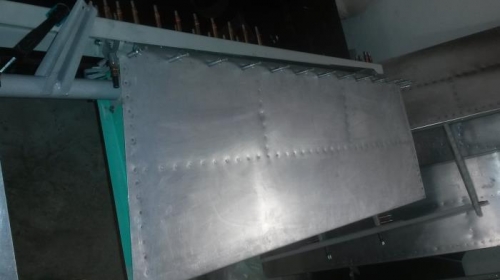

2. Corrugated conduit installed for Electric Pitch Trim actuator cables provisioning.
3. Final riveting of Elevator Assembly R/H performed acc. DWG number 355M4
except final installation of horn rib 355M4- 33 and tip fairing 355M4- 6
NOTE: Assembly completed without deviations.
