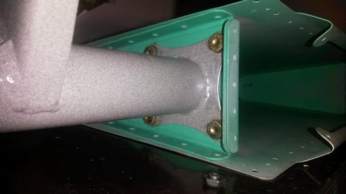

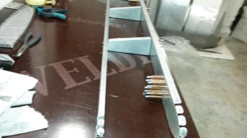

Brief Description:  Elevator Assy. L/H final assembly
1. Control fitting installed to L/H Elevator root rib with 4 ea. AN3 bolts and nuts
as per DWG number 355M4
2. Final riveting of Elevator Assembly L/H performed acc. DWG number 355M4
except final installation of horn rib 355M4- 33 and tip fairing 355M4- 6
NOTE: Assembly completed without deviations.
