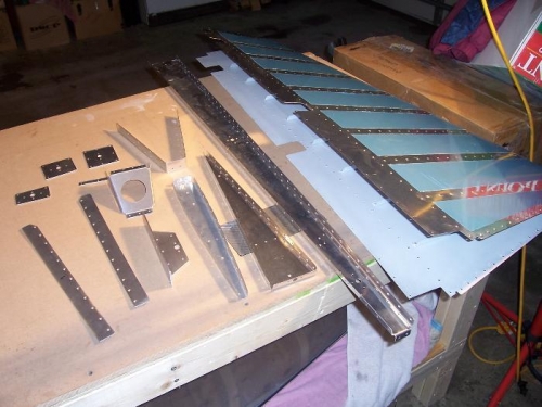

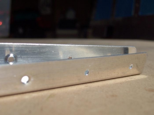

Disassembled the rudder after match drilling, deburred all the holes and edges, and dimpled as much as I could. I'm at a point where I need to buy a new tool. I could not get the dimple dies, or the pop rivet dimpler in the aft four holes of the R-703 tip rib (as seen in image 2). So I need to call Avery up and order the close quarter dimpler they make out of a vise grip. I also discovered I need to buy a dimpler and countersink for #10 screws to install the lead counterweight. But I have some time to get those items.

Rudder parts ready for priming...it will have to wait, though...
Yet another opportunity to buy a tool presents itself...
