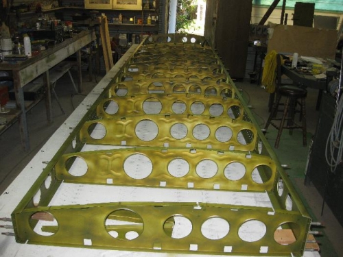

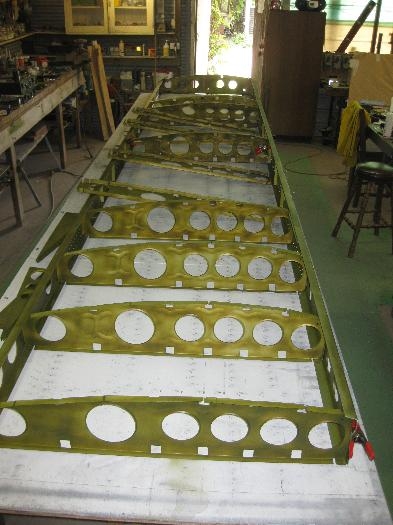

Clamped the spars to the work table, positioned the wing ribs and drilled the pilot holes to attach the ribs to the spars.
Like the first wing, the ribs are difficult to hold square to the spars due to poor manufacture.
They are rather floppy until the stringers are attached.
Getting the bits in the right places
All ribs in position.
