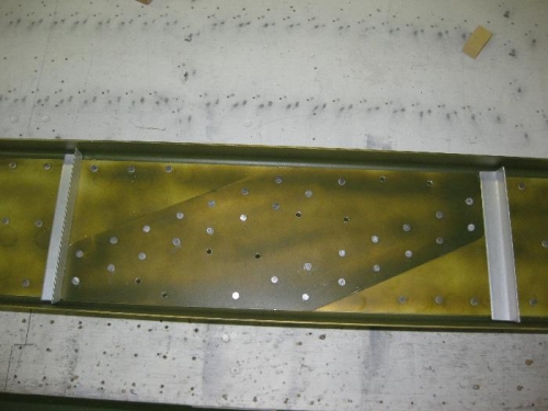

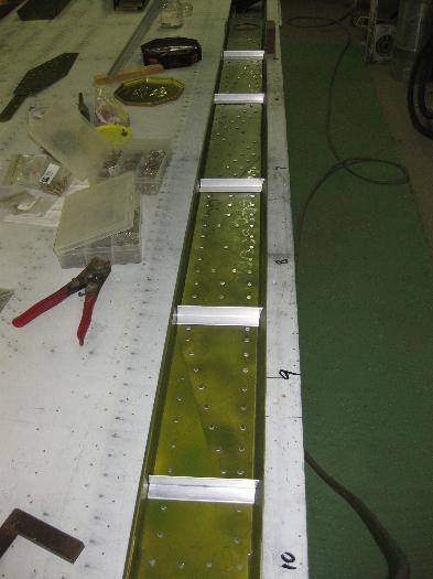

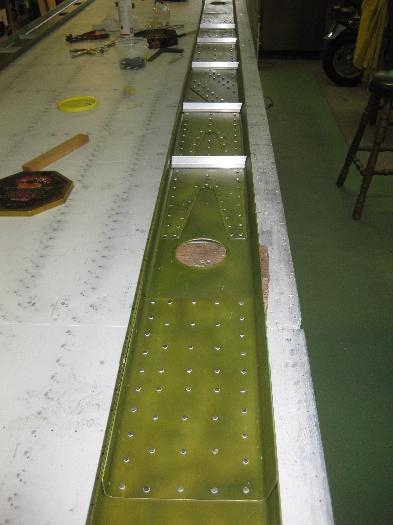

Assembling the spar reinforing plates , right wing
After predrilling and then priming the reinforcing plates for both spars, I then used solid rivets for the final assembly.
I made up the angle attachment brackets for the five wing ribs that had to be cut back due to the laminated plates inside the spars.
I then cut back the ends of the ribs that are positioned at these stations.
Much quicker doing this for this wing, unlike the first one!
Front spar
Rear Spar
Strut attahment strap backing plate
