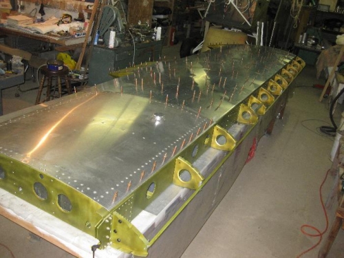

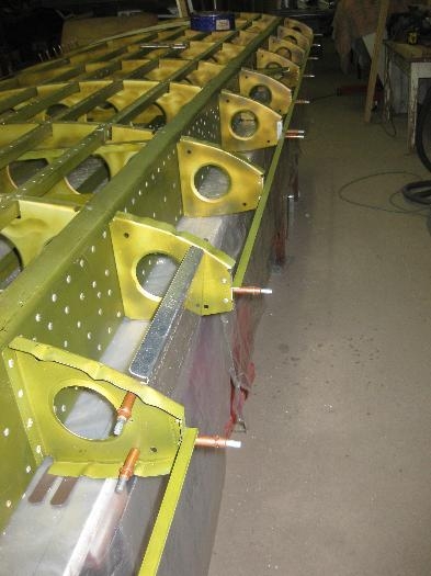

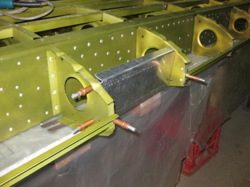

Leading edge ribs, left wing
Finished fitting the angles to the leading edge ribs after first replacing the top skin & tank and making sure all is aligned correctly.
The leading edge ribs are now securely held in place and I can now start fitting the leading edge skins.
Mounting plate for the Landing Lights
Angles running rib to rib
Top skin back on & Tank back into place.
