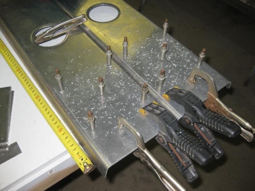

Brief Description:  Assembly of the root ends of the spars
After spending a considerable amount of time studying the wing drawings and identifying all the parts, and reading though the assembly manual, I actually made a start on the assembly of the root ends of the forward spars.

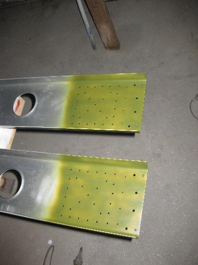

Both forward spar root ends

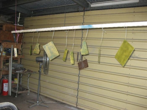

Drilled, deburred & etch primed
Root end other parts primed
