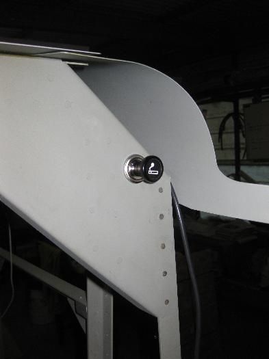

I decided to run a power wire direct from the battery (through a pull switch on the Panel) to the cargo bay. I placed a 15amp fuseable link at both ends of the wire. This power wire can be used in the future as a two way circuit, one to supply power to to the cargo bay (ice box to keep the beer cold) which can be turned on only when the engine is running at the panel, and 2 as an input for solar cell charging of the battery if desired during extended outback camping trips.

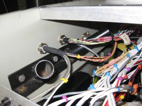

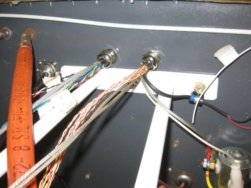

Also finished the last firewall penetration for the engine instrument wires.
Cigarette Lighter power in the cargo bay bulkhead
Instrument wires through the firewall
Final wiring peno through the firewall completed
