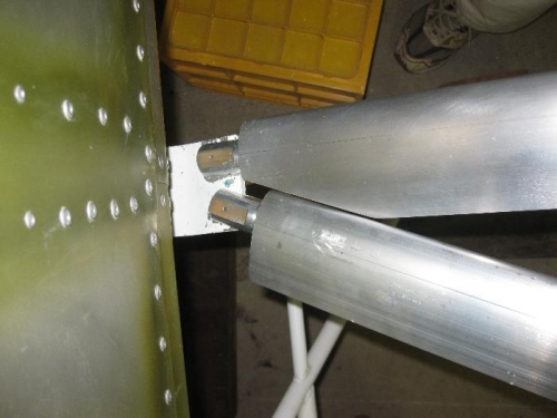

Today I measured and cut the Struts to the correct lengths.
Lots of carefull double checking.
I used my lathe for the first time in ages to skim down the solid round strut end attachments that would not fit into the ends of the smaller rear struts.
Also found that most of the bolts supplied for the strut attachment were the wrong length & size plus only 1/4 of the number required. Typical Bushcaddy...
Before drilling the pilot holes I will need to ensure that the chord of the strut sections are all level with the bottom of the wing at the wing root.

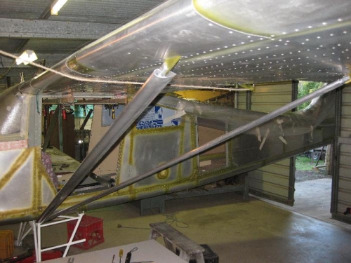

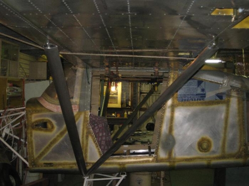

Struts in position
Struts in position
