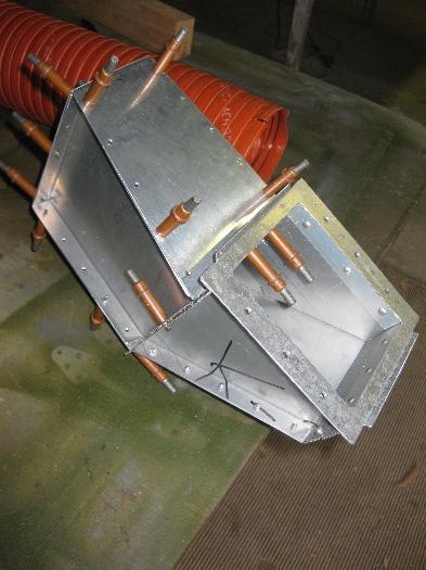

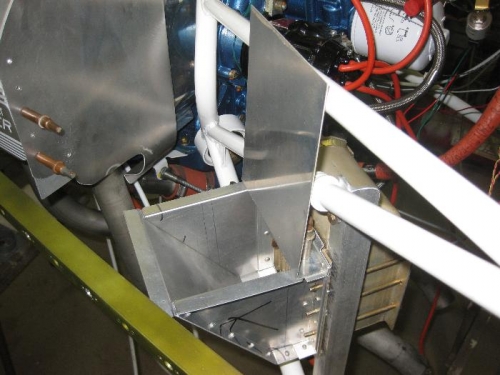

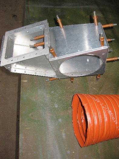

Over the last couple of days I tackled the job of making a duct to collect the air from the rear left baffle plate to the oil cooler that I decided to mount on the Engine mount.
The flexible connect between the Baffle plate and duct bolted to the oil cooler face is 5 inches diam.
Forming the shape insitu.
Oil Cooler Duct ready for final rivets & paint.
