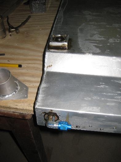

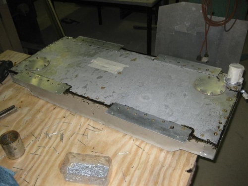

Over the last couple of days I decided to tackle the sealing and completion of the auxillary fuel tank that I started on some time back.

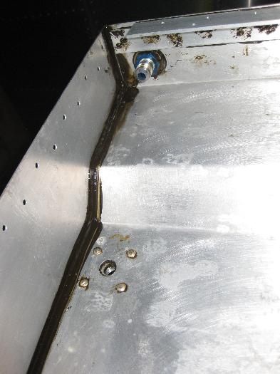

After making a final decission on the fuel pickup and vent tube connections along with the drain point, I used ProSeal in all corners and on all riveted angles supporting the tank top.
A messy job, and a relief to have completed this without too much drama.
I will use the 3M Fuel resistant Tank sloshing sealant before installing the internal fuel pickup and vent tubes.
Drain point & pickup connection
Proseal applied to the internal corners
Tank top fully riveted and prosealed
