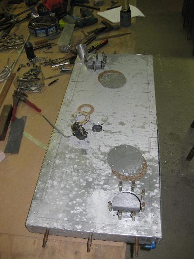

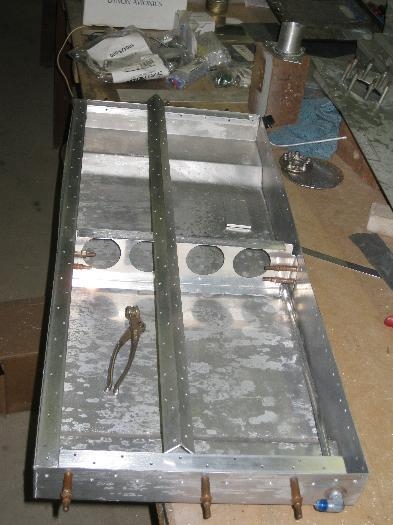

Spent today making up the baffle and tank top, along with inspection openings.

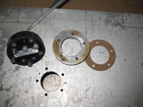

Also decided to install a sender unit.
The marine grade aluminium sheet has been water/sweat marked, but this wiil clean up prior to sealing and sloshing the tank and priming the outside surfaces.
Tank Structure
Tank Structure
Tank top with inspection plates
Fuel sender unit
Fuel sender unit
