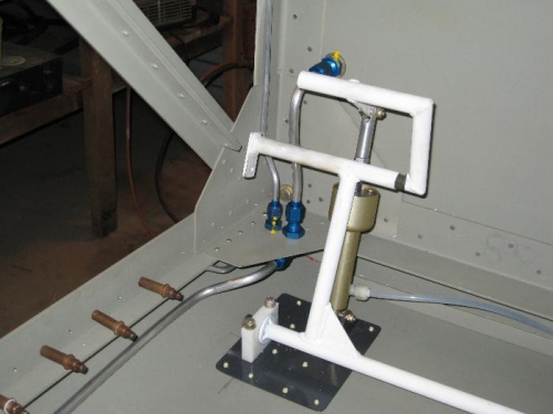

Last two days spent running fuel lines after the arrival from Spruce of my order for all the necessary fittings.

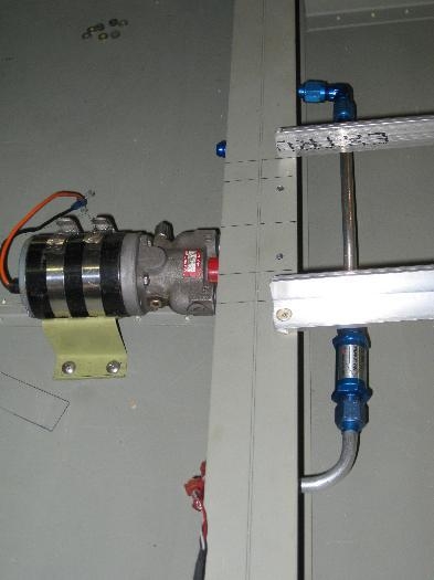

Just to ensure of no blockage in case of the fuel pump failure I decided to run a bypassing fuel line with a non-return valve around the electric boost pump.
First firewall peno for the fuel line to the lower left cabin corner.

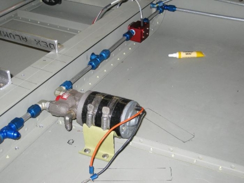

Pump and FT-60 Transducer
Boost pump by-pass line with oneway valve.
