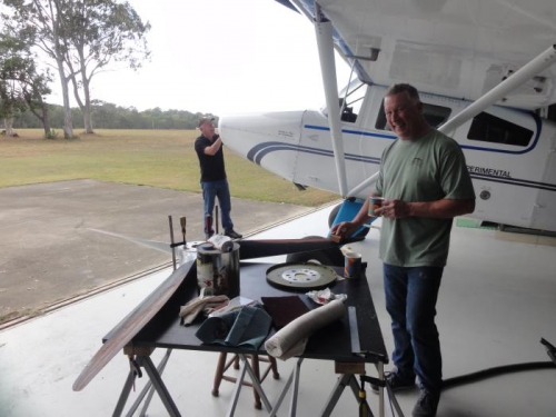

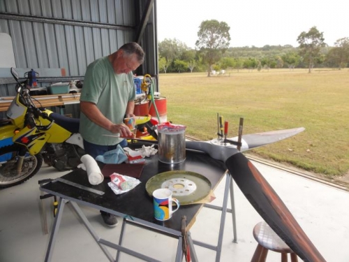

My good friend ( & 3 times RV's builder ), Goeff Carr came over and within and hour or so, the 3 of us had the 3 bladded prop off the L164 and Craig started work.
Within about an hour, Craig had sanded just a smidgeon off the trailing rear edge of each blade, applied some fast drying automotive body filler red putty, sanded that smooth & touch up painted each blade.
After lunch we re-installed the prop & spinner, and I took Craig up for a short flight.
I found that he had made an unbelievable difference, not only to the static and full power RPM, but also to the climb & cruise speeds of the aircraft. I could now get 2350 static & 2700 rpm full power in fast time. This small change also increased the climb performance & the cruise speed noticeably.

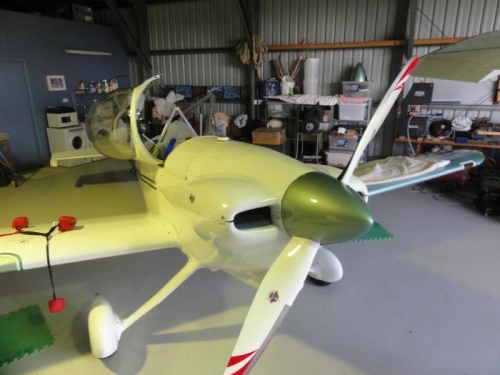

In the month or so after Graig had returned to the US, I finally managed to get the new Catto prop on my RV4, after having the engine & hoses rebuilt & installing a pair of new electronic EMags.
BOY OH BOY, what a change that has made to the RV
The combination of reduced aircraft weight, more ef

Craig solving the isue
New Catto F/P in my RV4
