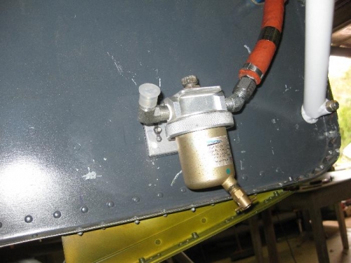

Brief Description:  Fitting the High Pressure Gascolator
I wasn't planning on this today, however after basically finishing the cowls, it was time to move back onto the engine bay, Baffles etc, and this was something that I had been putting off because I didn't know how I was going to make the bracket to support it.
I finally decided to use the plug hole in the top (where a primer line would go if you had one), and use a bolt through a section of 2 " X 2 '' x 3/16 angle, secured to the firewall.
It turned out very rigid, and a vacuum test on the fittings did not show any leaks.

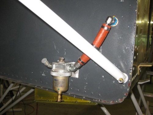

Gascolator on lower left of firewall.
