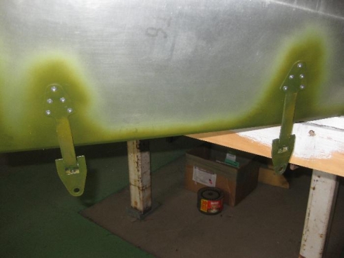

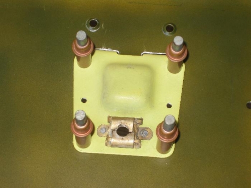

Tooday I finished fitting the receptacle plates into the right side lower cowl and installed the closure latches to the right side upper cowl.
Just waiting on the wing stud fasteners from MilSpec.plus one floating stud receptical.

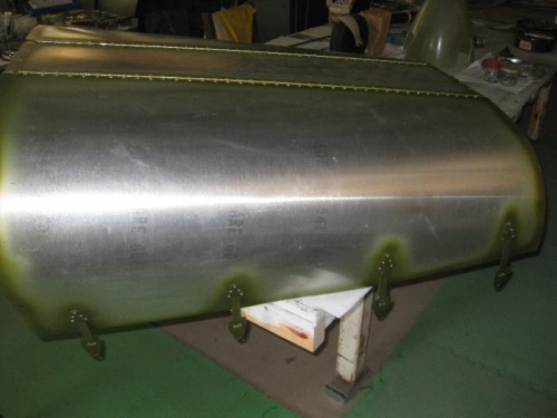

I also installed 3 wing type camloc fasteners on the right side upper cowl, and 3 additional SS camlocs on the left side, 2 at the fire wall and one each either side on the nose bowl, as I found that due to the spring in the Aluminium, they were required to hold the cowls hard against the mating surface on the fuselage & nose bowl.
Floating receptacle in the closure plate.
Over Centre, flush fitting cowl closures
4 on the right side.
