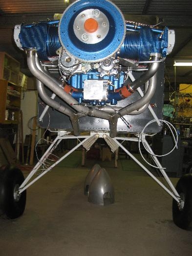

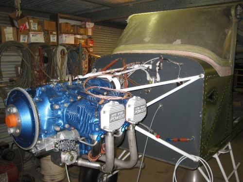

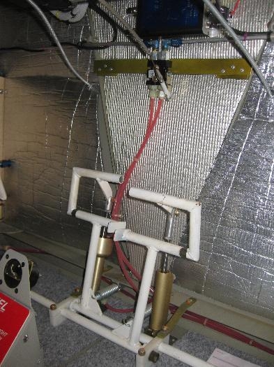

During the past two days I bolted the engine into place, temporarily installed the cross over exhaust system and then made up the braided brake line hoses down to the slave cylinders.
Had a lot of trouble trying to pump the hydraulic fluid up the lines with an oil can, so after doing a little research on the net, I copied a great idea and went to the local hardware store and picked up a small plastic pump up pressure container, I the changed the nozzle to fitt a clear plastic tube to fit the bleed valve nipple, and the simply blew the fuild up the lines.
This turned out to be a lot easier when you are working alone.
Still a few minor bubbles in the brake lines, so I'll redo the charging of the brake fluid during final assembly.
Engine mounted.
Engine mounted.
Crossover exhausts fitted
Brake fluid primed
Brake fluid primed
