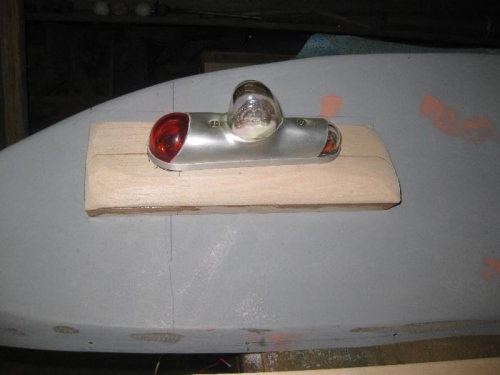

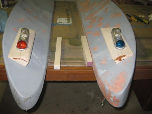

Having completed the riveting of the right wing, and whilst access to the wing tip was available, I decided to play around with the wing tip fairings and the mounting blocks for the position & strobe lights.
I decided to use a balsa form block and coat this with a fibreglass coating and attach this to the wing tip fairing supplied with the kit.
The quality of the fairings supplied with the kit are very poor, however I have decided to use them mainly due to time constraints
Selecting the position & orientation of the fittings
Starting to shape the mounting block
