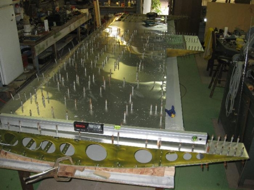

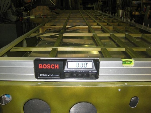

After setting up the washout into the wing structure and clamping to the table, I moved the bottom skin into position and after much double checking of alignment, started drilling through the skin pilot holes into the stringers & ribs.
Once again, used all the 3/32 clekos.
Next step, drill to 1/8 and then remove skin for de=burring and etch priming.

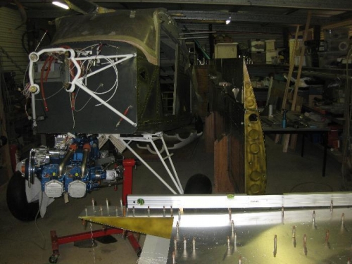

Unwrapped the engine and started thinking about lifting this onto the engine mount sometime soon.
Wing root end level
Wing root end level
Pilot holes drilled into stringers & ribs
Even got to take another look at the engine today.
