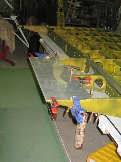

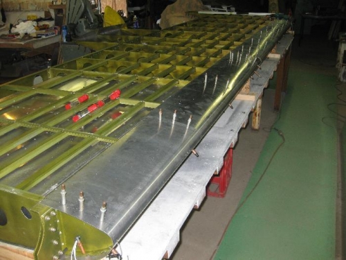

Having pre-drilled the bottom skin pilot holes yesterday, today I placed the wing structure back onto the table bottom side up and finished the fitting of the leading & trailing edge skins.
Set up a string line along the trailing edge tips to check alignment prior to drilling the pilot holes.
Wing bottom leading edge drilled
Clamping & drilling trailing edge

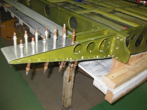

Trailing edge at right wing root.
