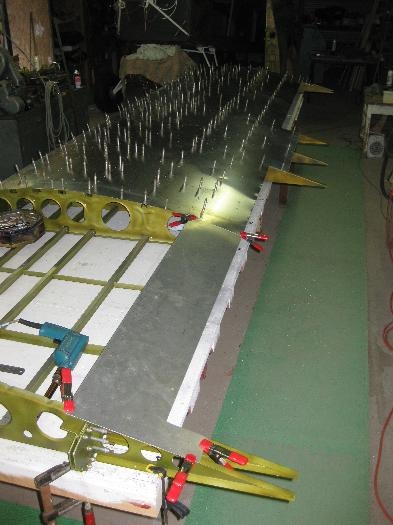

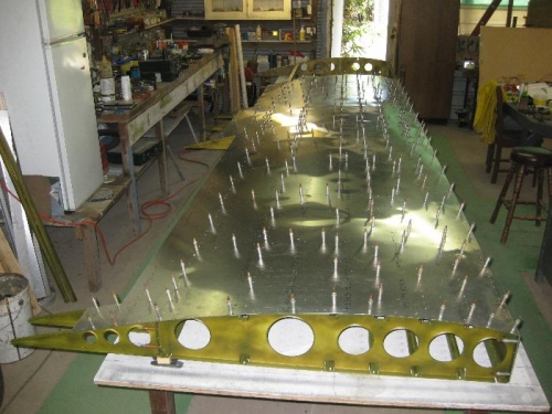

Yesterday I marked the rivet lines and drilled the pilot holes for the top skin on the right wing.
Today I lowered the framework back onto the work table , positioned the skin into place, checked the diagonals a number of times, chocked the trailing edge at the wing tip for the washout, clamped it all to the table and started drilling the pilot holes.
Also made the cut outs on the skin where the flap & aileron openings occur.
Made up the section of skin to the rear of the fuel tank and clamped into position.
Top skin, right wing held in clekos
Skin behind fuel tank in position.
