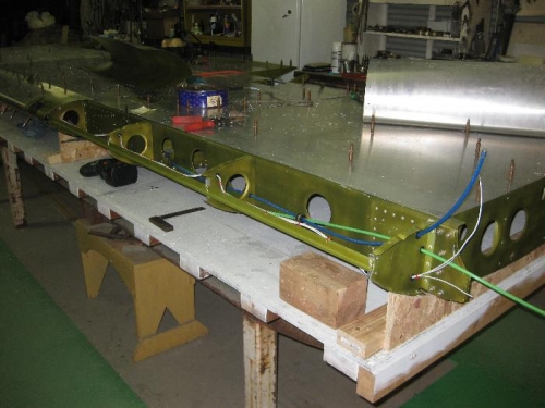

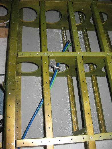

Pitot tubing & AOA tubing.
Removed the leading edge skin and ran the AOA & Pitot tubing from the wing root to the Pitot access panel that I completed yesterday.
Green for the ASI from Pitot & blue for the AOA.
