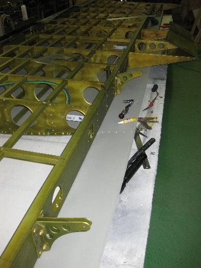

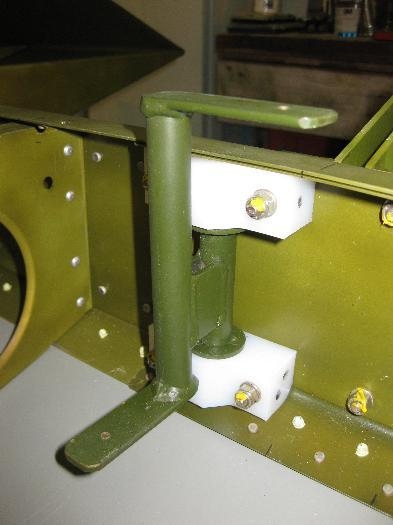

Brief Description:  Fitting the aileron & flap hinge brackets etc.
After finishing the pre-drilling of the bottom skin yesterday, I then made the cut outs for the access panels and the aileron in the bottom skin before moving it aside and replacing the wing structure back onto the work table.
I then started to bolt into place the aileron & flap hinge brackets for the final time, and after using the torque wrench set for the AN3 bolts 60 inch lbs, I used the 'Torque Paint' on evry nut to show that it was a final install.
