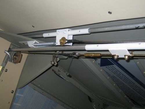

In order to finalise the internal linings, the control cables had to be passed through some of these, so the final fitting of these cables need to be done together with the linings.
Found I had cut the aileron cables slightly too short so purchased a couple of longer turnbuckle ends which should solve the problem.
Aileron & Flap cables

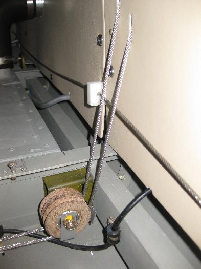

Through guide pulleys bolted to cabin side.

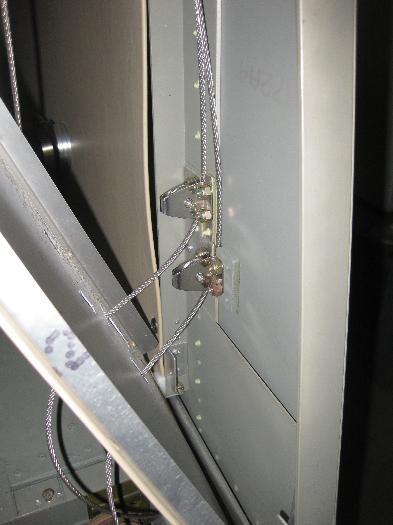

Upper Cabin connections
