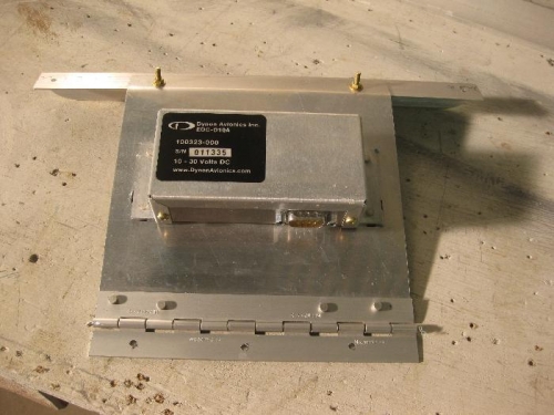

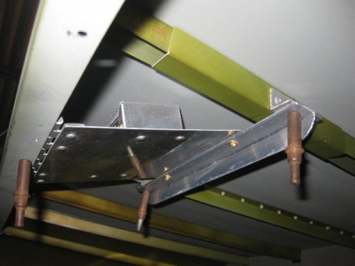

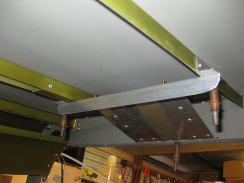

Dynon Remote Compass mounting
I decided to mount the Dynon remote compass in the upper fuselage just aft of the number one bulkhead.
To get the required angle to match the angle of the dynon unit in the dashboard required a bit of fiddling around with the laser level.
I used brass screws and soft aluminium hinge wire in the mouning hardware to avoid any magnetic influence.
Much easier doing this work now before joining the Cabin & Fuse together.
K.I.S.S.
