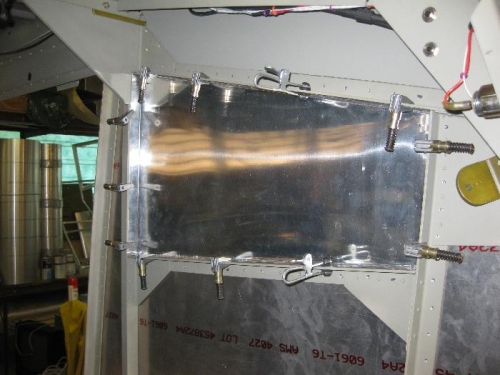

I did not like the way the rear windows were to be installed, without an internal frame lining around the inside of the polycarbonate. It would look ugly from inside, so I decided to make up the internal frame from thin alclad sheet.
Folded up some thin alclad to suit the internal frame.

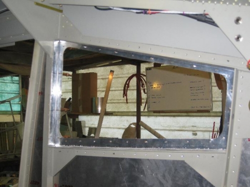

Cut out the opening
Cut out the opening

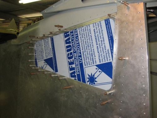

Fit the Polycarb
Fit the Polycarb
