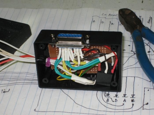

Brief Description:  Making the trim priority relay
A good day yesterday.
I decided to combine the PTT inputs from both Pilot & Co Pilot through the connector to the Trim Priority relay box for ease of making the connection and elimination of the need to have a separate connector. This also had an added advantage of eliminating an extra ground wire.
I tested the circuits & no smoke appeared, so very satisfied with the result
When installed, the relay box will be fixed in place on the cross member below the front seats & wires run up to the various connections behind the panel.
Trim Priority relay box finished.

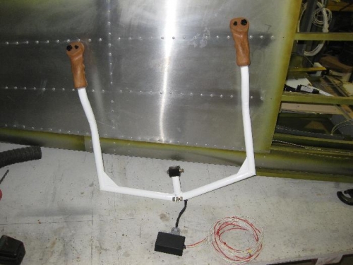

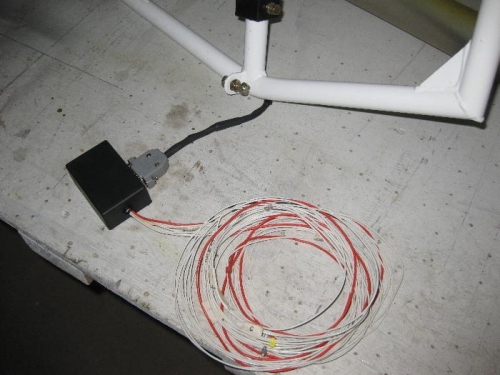

Enough wire to be run in one length to the appropriate connection.
Control yoke and wires.
