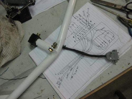

Date:  1-27-2012
Number of Hours:  7.00
Brief Description:  Control yoke wiring.

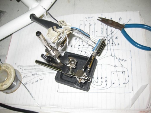

I wanted to make the control yoke so that it can be removed at any time without having to cut wires, or make joints at some time in the future, also I am not ready for the final install of this item yet, so I used a DB 15 solder connector.
Also used heat shink at every oportunity on the understanding that it helps to stop the smoke from getting out of the wires!!
The aligator clips and stand are a second set of hands and well worth the couple of bucks outlay.
Finished yoke wiring connector and my rough sketch of the wiring plan.
