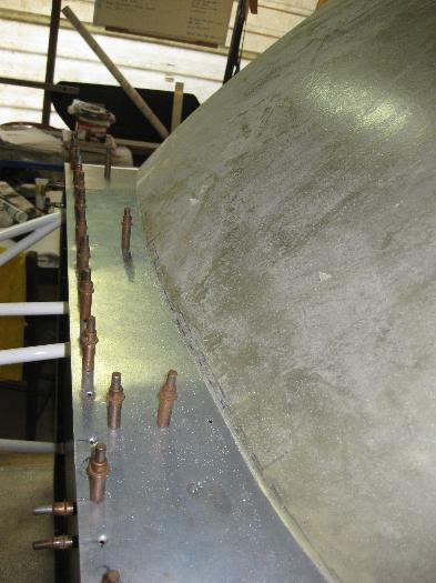

I had worried about this section of the works for too long, due mainly to not having done it before and the lack of info in the drawings and construction info, but as it turned out, no big deal.
I was very carefull to only trim a little at a time.

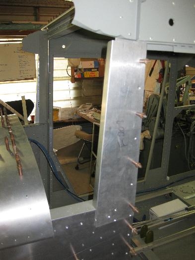

Before going too far I had to install the door post external moulding parts (F208), by clamping in place and to start with, back drilling though the allready drilled holes for the side skins at the corner.
I had to de-rivet the cabin roof skin along the front top of the cabin after working out how the screen mouldings in this area were to be positioned in relation to the other parts...

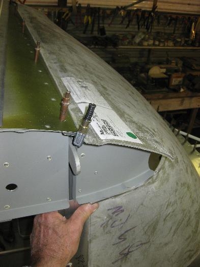

Trimming around the turtle deck
Fitting around the false wing root rib, right side.
Door post moulding part 208 installed both sides.
