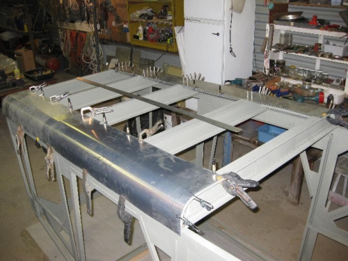

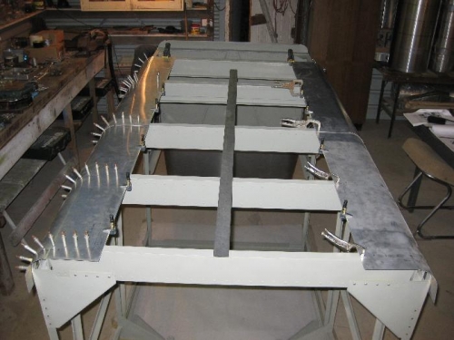

Brief Description:  Fitting the lower corner skins first.
The construction manual indicates the average time for fitting the bottom skins as 4.25 hours.
It is my feeling that the decimal point is in the wrong place. (should be moved to the right at least one space).
Whilst I spent at least 6 hrs to get this far today, I did spend a fair amount of time marking the layout of the undercarriage mounting brackets and planning how I was going to tackle the process of installing these.
