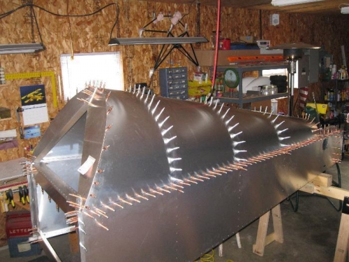

Brief Description:  Position drill and cleco turtledeck formers.
Today I clamped the turtledeck formers and pilot drilled the formers and the clips. This was a much easier process than I had imagined. I need to updrill the formers, however I am now out of 1/8 in (250) clecos. I can remove several from the turtledeck skin and tail cone for now.
