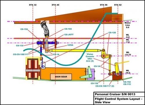

1) This view shows various parts of the side stick controller that cane be viewed when looking to the right with the left side removed. The various CG Products parts are called out in their specific locations. Parts that are YELLOW are for the Elevator and parts that are BLUE are for the Aileron.

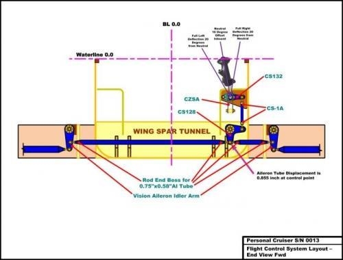

2) This view shows is from behind the main spar looking forward and shows many of the Aileron system components. The control deflection at the Idler Arm from the Vision is maintained in this design so the aileron response should be comparable.

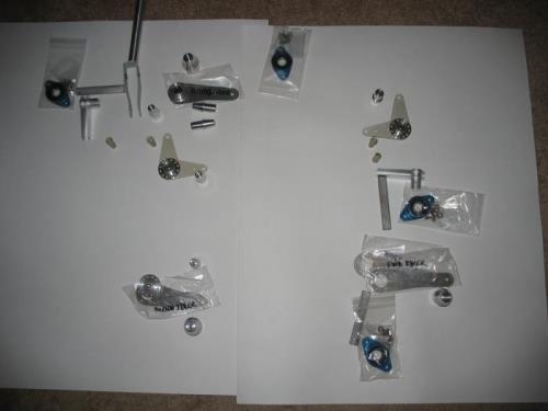

3) The parts assortment were purchesed from CG Products and Pro Composites to fabricate the hybrid control system that would be mounted within the fuselage mackup. All parts are of high quality and will save a lot of time in fabrication.
Controls Looking Right
Controls Looking Fwd
Ctrl Parts in Relative Locations
