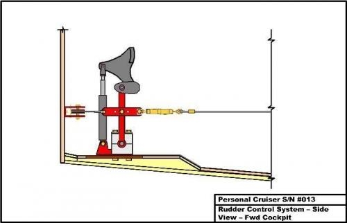

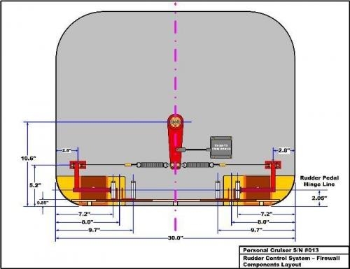

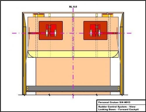

Brief Description:  Rudder Control System Design
The Rudder control system is basicly stock to the Vision 2 place aircraft. The major modification is to add a variable end point for the cable attachment that allows for rudder tirm. This utilizes a RAC trim servo to shift the center arm as desired via a switch on the control stick. The rudder pedals are a commercial product available through Aircraft Spruce and modified with extensions to keep the cable runs close to the side of the aircraft. The cables are routed to the aft end of the fuselage utilizing NylaFlow tubing as a durable conduit.
Side View of Rudder Pedal Placement
View or Firewall and Rudder System Components
Top View of Rudder Pedal Mounting
