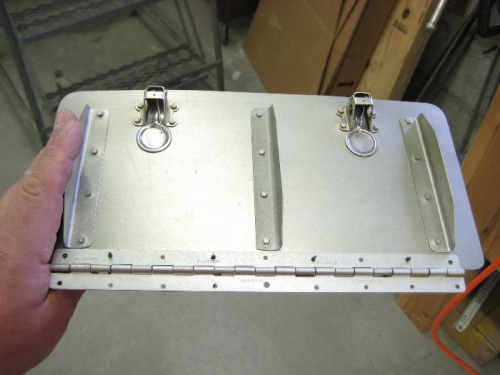

Cleco Camloc latches to access panel.
Rivet latches using p-squeezer.
Cleco panel stiffeners in place.
Cleco panel hinge in place.
Rivet stiffeners and hinge using p-squeezer.

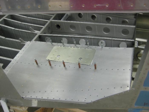

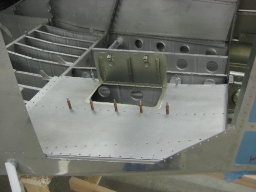

Cleco baggage area access panel doubler in place.
Cleco panel/hinge and hinge stiffener assembly to baggage area floor.
Rivet assembly using p-squeezer.
