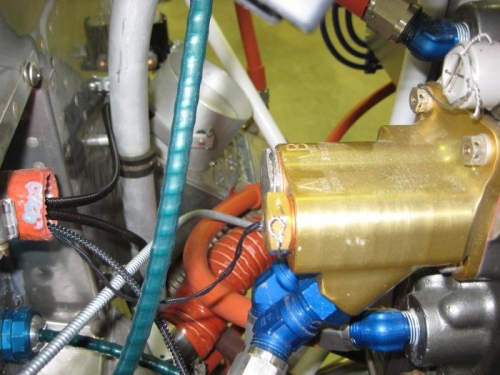

Today I installed the engine oil temperature sensor and wiring.
The sensor was installed per the instructions included. The sensor was safety wired with the Vernatherm.
Extension wires were installed using 20 AWG twisted pair cable. The extensions were spliced to the sensor wires using knife blade connectors for ease of future maintenance. The knife blades were attached, connected and protected with heat shrink tubing.

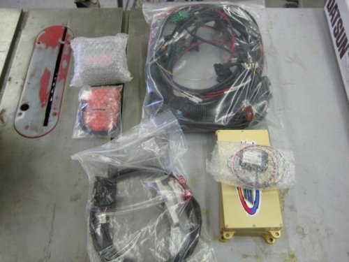

The remainder of the time today was spent removing the EFII system wiring. I am upgrading to the System32 and the original equipment has been sold.
