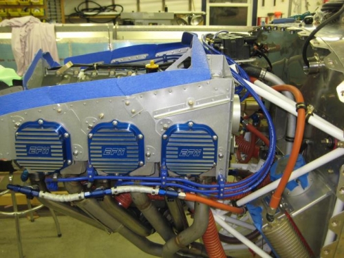

Brief Description:  Install Ignition Wires
1600 - 1918
Continue with ignition wire installation.

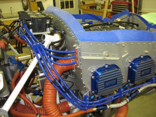

I ended up needing to shorten the wires that I had worked on yesterday. I had extra wire ends, so I cut the wires to the new length and installed new ends.
I then used wire separators to route the wires. Two of the separators were screwed together and tie wrapped to the engine mount over rubber tape.

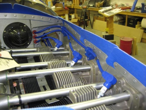

Next I worked on the 2-4-6 side. I installed the baffle pass through with silicone grommets and 6-32 hardware.
Installed bottom ignition wires in the wire separator standoffs that were previously mounted.
Routing was determined.
