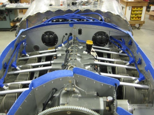

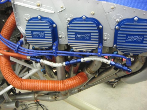

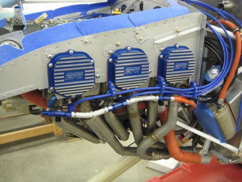

Begin Plug wire routing and install.
I verified that there was clearance between the top cowl and coil packs first...there wasn't.
I needed to shift the coil pack mount to the passenger side and angle it from back to front to obtain satisfactory clearance. Once in position, all mount clamps were tightened and the individual coils were positioned and secured.
Next, I ran all the plug wires to determine optimal routing.
