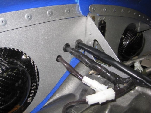

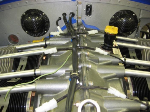

Today I finished modifying the preheat system wiring to provide a clean installation.
Locate and install grommets in the #5 baffle for system wiring.

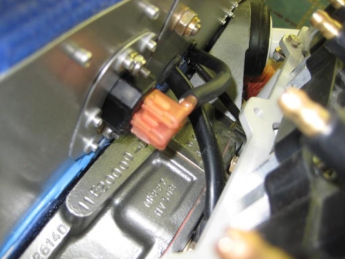

Shorten power cord to appropriate legnth and install flag connecotrs using standard techniques.
Install Adel clamps to support system wiring.
