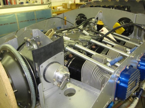

Clear coat engine mount covers.
Install engine mount covers. A small bead of RTV was applied to the cover flange to ensure a seal. Screws were secured with blue loctite.
Trim baffle material for governor gasket, punch screw holes.
Install governor gasket and doubler using 6-32 hardware.
Install internal lock washers on baffle mount screws.

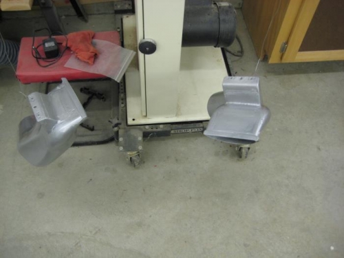

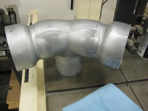

I opted to paint the intake plenums.
Prep the plenums for paint.
Apply adhesion promoter, per instructions.
Apply 2 coats of rustoleum 2X Metallic Aluminum paint per instructions.
