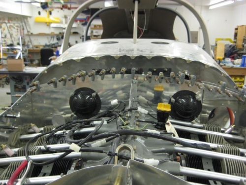

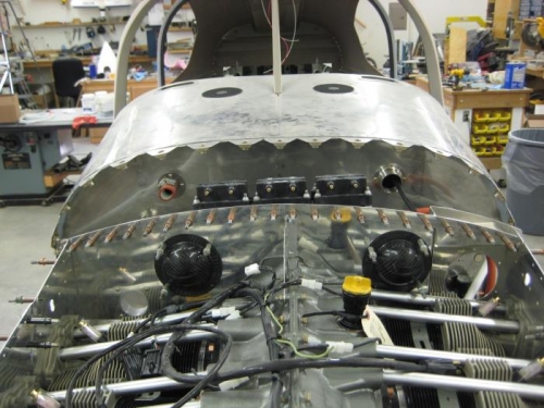

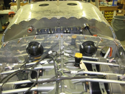

Fabricate aft engine baffle backup strip using standard techniques.
Clamp, match drill, and cleco strips to baffle.
Remove clecos.
Debur and smooth all holes and edges.
Cleco strips to baffles, verify fit.
