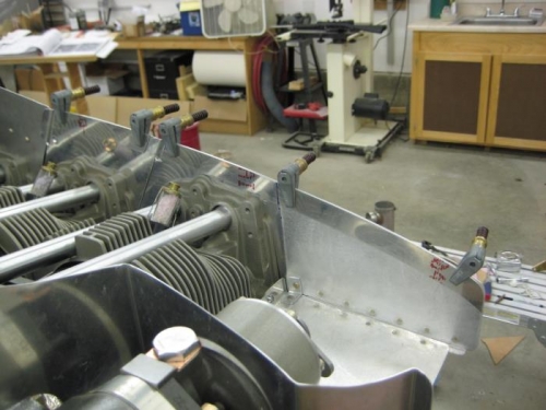

Finish sand and smooth upper inlets and ramps.
Begin fabrication of baffle backup strip. This will be used to support the baffle rivets and spread the clampnig load over a larger area of the rubber baffle. The strip is fabricated from 032 sheet, a nominal 3/4" wide and contoured to the engine baffle. There will be three pieces per side.
