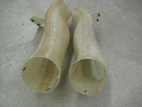

Install nut plates for intake plenum retention.
Nut plates for #6 screws were installed around the circumference of the plenum and #8 on the upper mounting flange. Standard install techniques.
The hole locations were altered to provide unimpeded access to the screws when intake system is fully installed.
