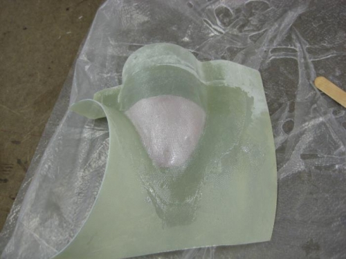

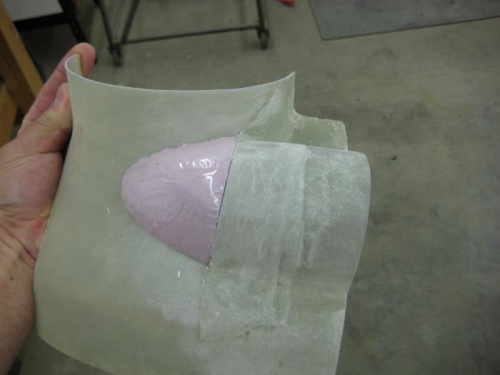

Fabricate foam plug for governor shroud from pink foam board.
Sand to shape, cover plug with packing tape.
Mix epoxy.
Lay up two layers of 9 oz f/g over plug.
Trim engine mount cover to approximate dimension.
Locate 3 mounting holes in cover flange.
Verify fit and edge clearance of cover hole locations.
