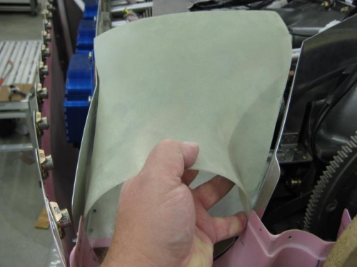

Begin fitting the upper inlet ramps.
Trim the right ramp, install cowl, verify fit, repeat.

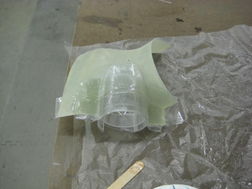

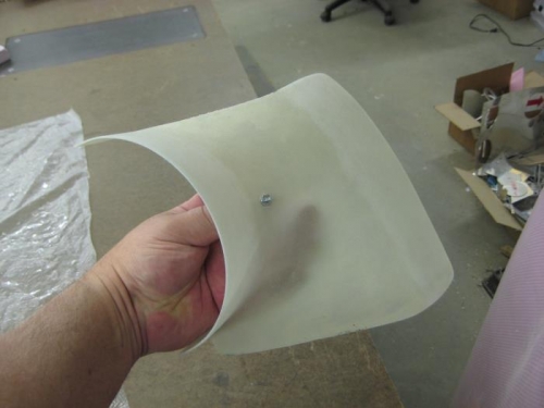

Trim left ramp, install cowl, verify fit, repeat. The left ramp needed to be trimmed to accomodate the governor. This left a fairly substantial gap around the governor. I decided to modify the ramp with fiberglass to surround the governor and preserve upper cowl pressure. This process has been detailed before in earlier log entries.
