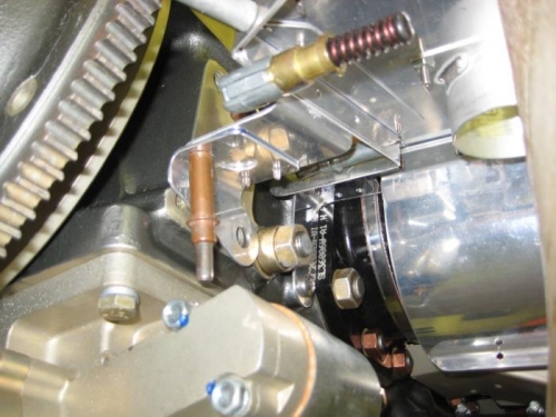

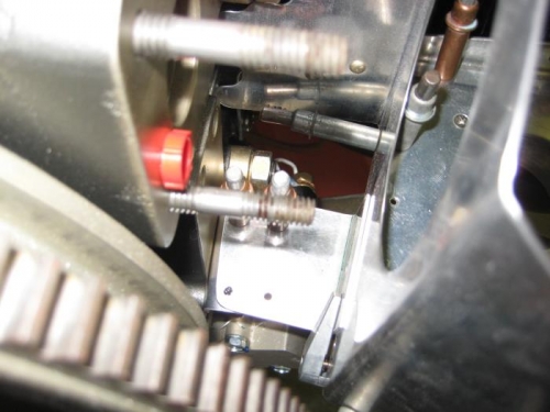

With the Showplanes cowl, new inlet ramps were fabricated. This precluded the use of the left ramp support bracket.
Today was spent designing and fabricating a replacement support bracket. Photos show rough shaped bracket, clecoed in position.
Bracket was fabricated from the original bracket with an extension. The extension will be riveted to the original bracket and the forward baffling.
